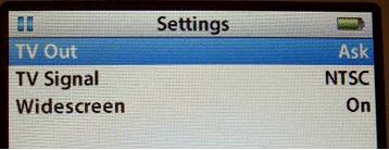

    (2) Set up your iPod opinions
    Open iPod settings, choose Videos and then Video Settings from your main iPod menu. This screen offers three settings: TV Out, TV Signal and Widescreen. Adjust to produce the video playback style you need.
    TV Out
    Whenever you play a video file, your iPod must make a choice. Video iPods either play video on the built-in screen or they transmit a video signal out of the microphone jack. They don't do both. The TV Out option controls which behavior occurs.
    Use this setting to choose from:
    No. Playback remains on the iPod itself.
    Yes. A TV signal is produced.
    Ask. The iPod prompts you whenever you play a video file.
    I always use the Ask option. Yes, it does add an extra step whenever I play a video file, but it gives me the flexibility to choose playback behavior on a case-by-case basis.
    TV Signal
    European and Australian television sets use a different signal standard than those used in America and Japan. If you live in the U.S., your TV works with the NTSC standard. European countries mostly use PAL. Make sure you've selected the correct signal for your country.
    Widescreen
    iPods can play back widescreen video, if only on exported video. The built-in screen uses a traditional 4:3 screen ratio, rather than widescreen's 16:9 proportions. Choose Yes to produce a widescreen signal, or No to export the traditional TV output.
